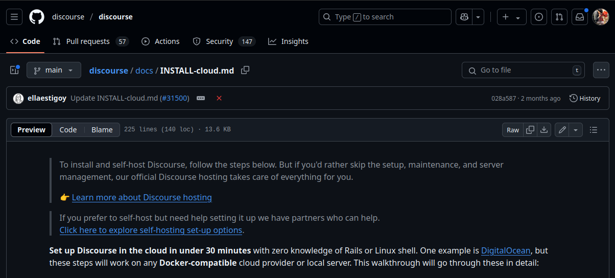

Discourse provides an official self-hosting guide. The installation itself was not very difficult, but there were two disappointing points.
The first is that it requires a separate email server. Email is a surprisingly difficult area to self-host. Residential internet connections often block outbound mail ports and use dynamic IP addresses, so they are not suitable for running a mail server. I wanted to support only third-party login options such as Google or Apple, but there was no obvious way to do that.
Fortunately, I was already renting a server from Hetzner Cloud and running a personal mail server, so I could solve the problem. Still, it was disappointing that a fully self-hosted setup was not simple. I expect this to be a big barrier for users who want to run Discourse for free.
The second issue is that installation requires learning its own CLI tool instead of using Docker directly. It uses Docker internally, but rather than pulling a finished image, it dynamically builds the image through its tooling. That means you need to learn commands like these:
./launcher rebuild app # rebuild app
./launcher stop app # stop app
./launcher start app # start app
Software distributed with Docker usually has the advantage of a consistent and easy experience. A Docker user can write a docker-compose.yml file and run docker compose up -d. With Discourse, you need to understand both Docker and its own CLI, which can feel inconvenient.
After some trial and error, the installation itself finished without much trouble. I then connected it to my reverse proxy, configured the domain and SSL certificate, and completed the setup.

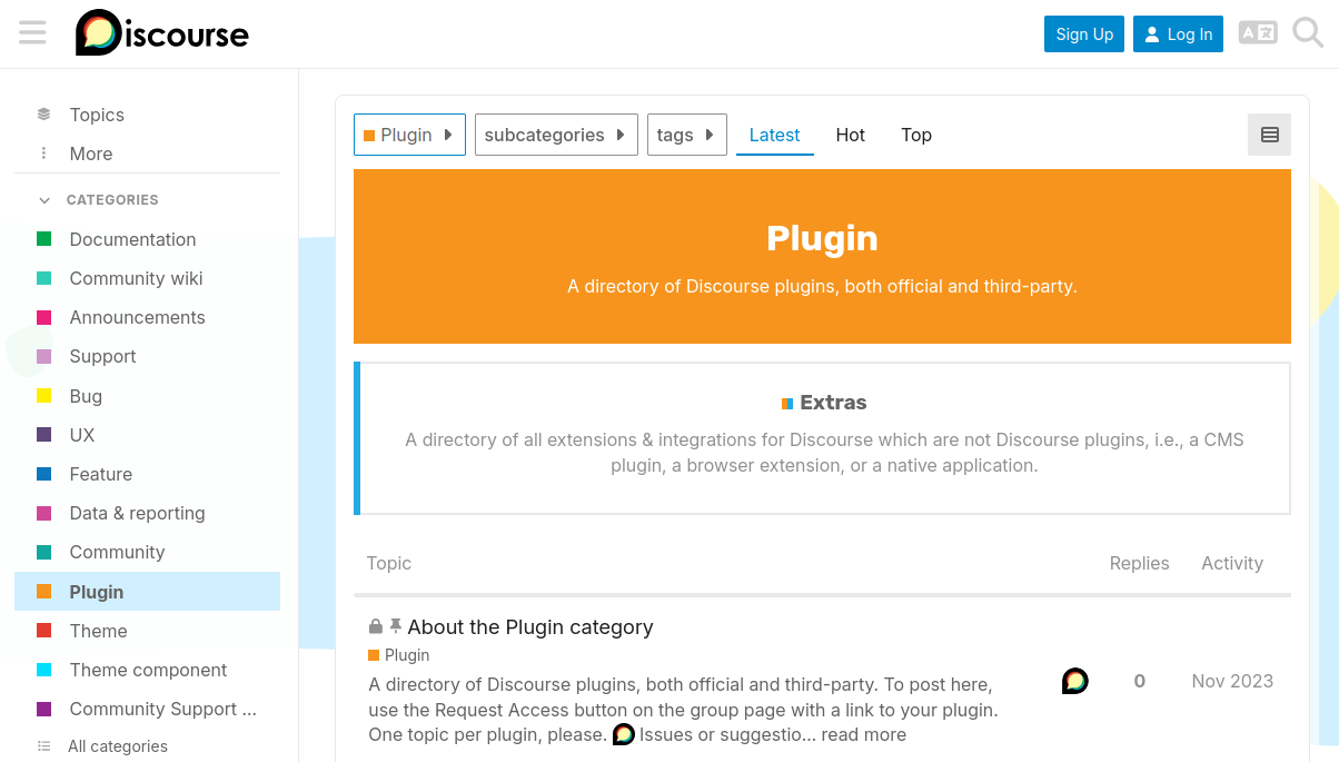

After installation, I noticed a few missing features. I looked through the official forum plugin page, installed and tested several plugins, and eventually chose these:
  • Apple Auth: Apple login support, while Google and GitHub are already supported
  • Doc Category: shows a document table of contents in the sidebar
  • RSS Polling: automatically imports blog posts into Discourse
  • Solved: lets users mark a solution for question posts
  • Mermaid: supports Mermaid diagrams in the editor
  • Reactions: lets users react to posts with emoji

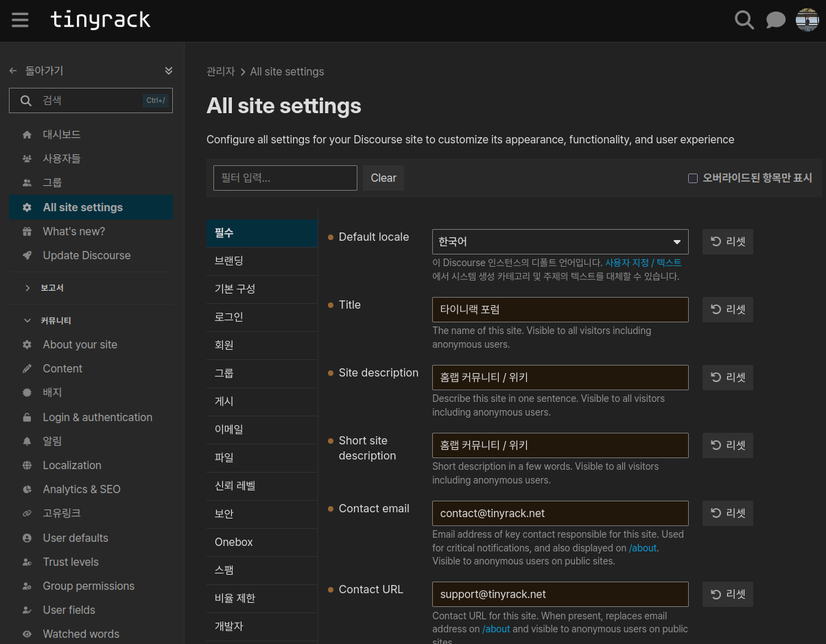

After configuring plugins, I changed the options I needed:
  • Branding, including name and logo
  • Landing page setup
  • Third-party login settings
  • Sign-up terms
  • Font changes
  • Blog integration
  • Translation improvements
Almost every Discourse option can be adjusted from the admin page, which was convenient. After the initial setup, I do not expect to use the terminal often unless something breaks.

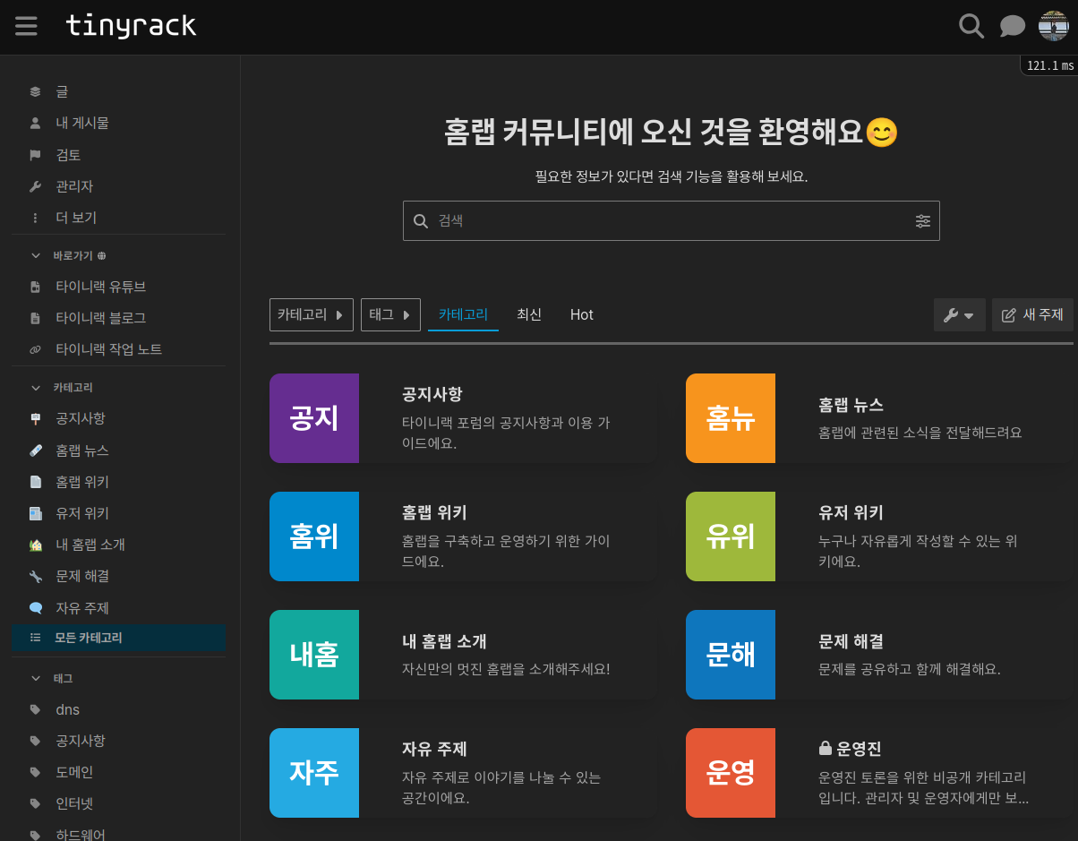

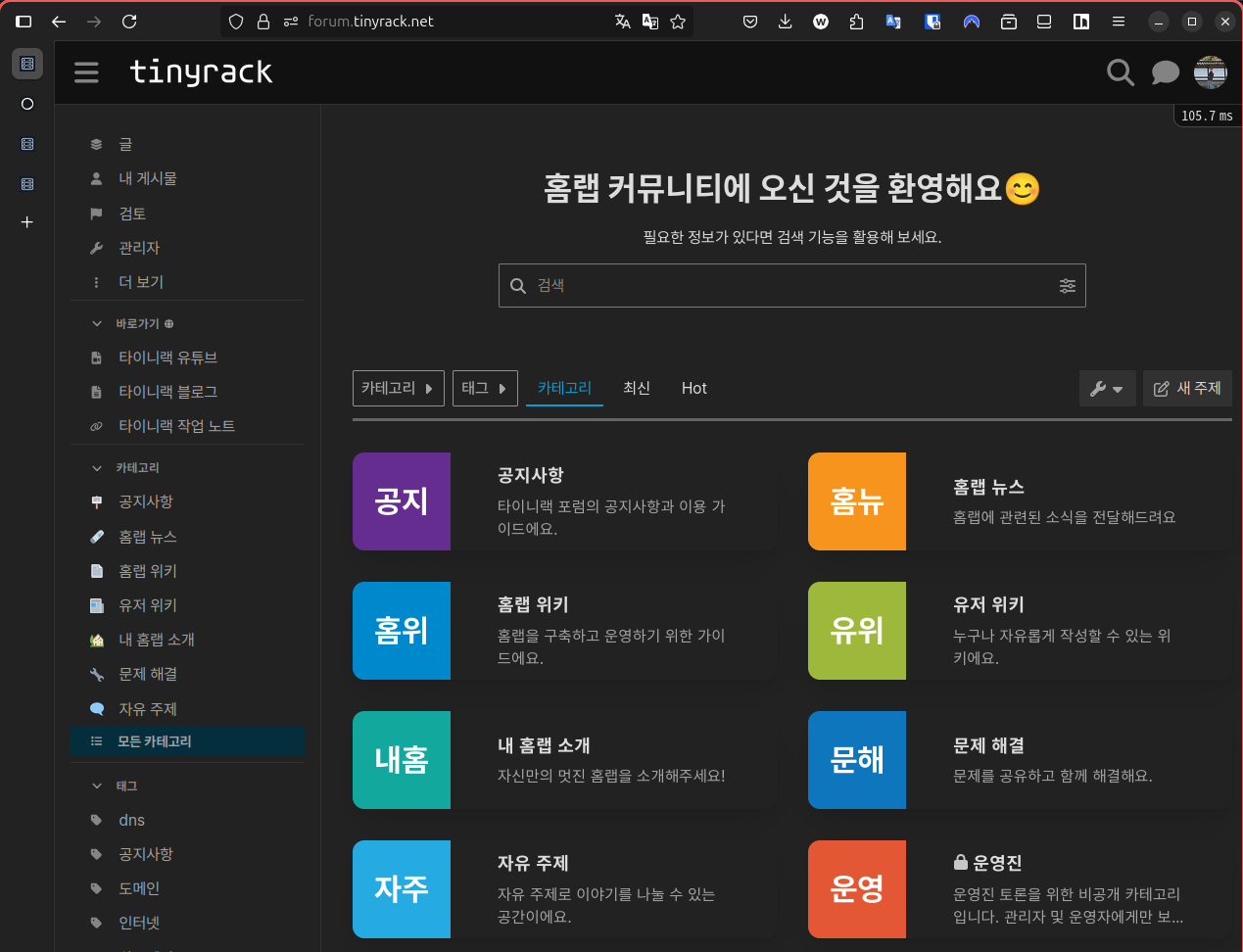

Done!
The forum is now mostly ready. There are still many posts left to write, but I think it will become a better forum as it fills up. Based on my experience so far, these are the strengths of Discourse:
  • The built-in search is excellent.
  • Search engine optimization is well handled.
  • The UI and UX are polished.
  • It has many good writing features, including Markdown, HTML, and Mermaid.
  • It integrates well with other apps, including embedded comments and RSS polling.
  • Site backup and restoration are easy.
  • Third-party login through OAuth is easy to integrate.
